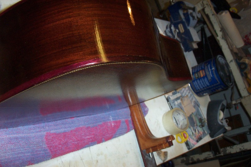

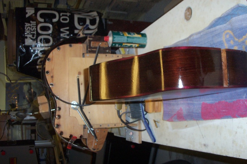

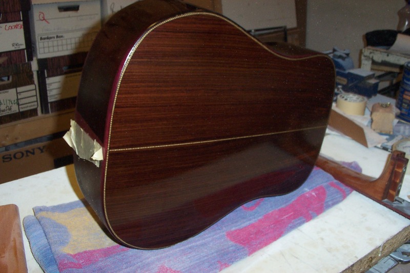

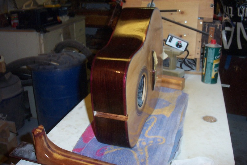

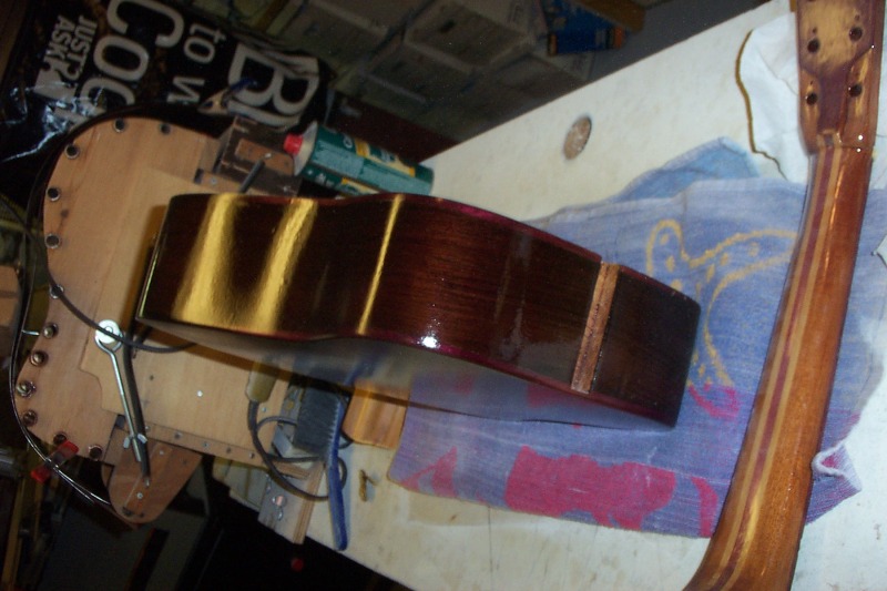

Following up on my promiss and your vote of confidence, i took a few more shots of my finishing progress, here's the soundbox shy of a few more coats before level sanding...and the rest
Thanks for watching!
